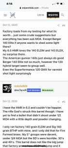

OP, I was curious whether that barrel twist is intended for the bullet you are using. In a quick search, I found another 6.5 Bergara user who wrote that everything BUT a Berger 140 groups sub moa, including other 140’s. It makes me think the Berger bullet you are shooting is long for the twist and on the cusp of instability where severe flyers occur.
I have shot groups like that when my twist rate is too slow. If a shorter, lighter bullet groups well, then twist might be the problem, even though I think you have an 8 twist, and that’s the minimum rate Berger prints.

I picked up a Bergara 6.5 Creedmoor and have been working on a load for it. I’m shooting Berger 140 gr Target bullets using H4831SC. Initial results were horrible so I glass bedded the stock. Attached are the pictures of the targets from today. Temps were at 70-80 degrees with a slight right to left breeze (approx 5mph). I also attached a picture of chronograph results (Caldwell). I like the Erik Cortina method and am looking to do the seating depth next. I’m looking for opinions on what powder charge y’all would look to…thanks in advance for any input!!!

I'm still wondering when people started shooting ladder group tests?
Shoot your ladder test using your target, or a chrono to find your powder charge nodes.
THEN shoot groups adjusting your seating depth.
From what i'm seeing of your groups, your testing is giving you zero useful information.

The first sentence says it all.
Your trying to do 2 things at once.
Do only 1 thing at a time. That way you can read & identify what is actually going on.
Ladder test, or velocity test over a chrono, is going to tell you what powder charge your barrel likes.
Seating depth test will then tell you what the bullet likes by group size.
If your bullet doesn't like the seating depth, how are you gonna have good groups regardless of what powder charge the barrel likes?
