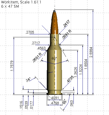

Paul, do you have a 6x47SM case to compare with the Lapua 6.5x47? Looking at the pictures of the 6.5L next to the 6BR and of the 6SM next to the 6BR they sure look identical but for the neck size.

I don't have a 6x47 SM,Ruag). Jason does, I'm going to send him a couple 6.5x47s and some 6XCs.
Looking at the 6XC, it is also very similar dimensionally,just about .030" longer body with with a slightly longer neck.) Shoulder is .451" on both sample cases I have.
Look at the 6x47 SM QuickDESIGN drawing. This is supposed to be CIP spec. Bigger at shoulder,.4563"), and noticeably longer neck. The SM is longer by .014" or so and most of that is neck:
6x47 SM = 1.8504" OAL
6.4x47 Lapua = 1.836" OAL
So I'd say the Lapua is more a slightly shorter 6XC than a SM clone.
