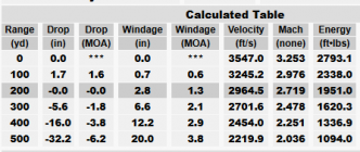

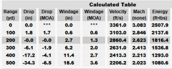

I'm gonna make sure I'm grasping this correctly. Using Nosler load data for 100gr Ballistic Tip bullets in both the 25-06 and the 6.5-06 A-Square, max loads and associated BC:
25-06: 3361 fps, .393 G1
6.5-06: 3547 fps, .350 G1
25-06 ballistic table:
6.5-06 ballistic table:
2206 -vs- 2219 fps
1080 -vs- 1094 ft lbs
Someone is going to have to help me understand how the 6.5-06 has 30% more energy at 500 yards compared to the 25-06??
