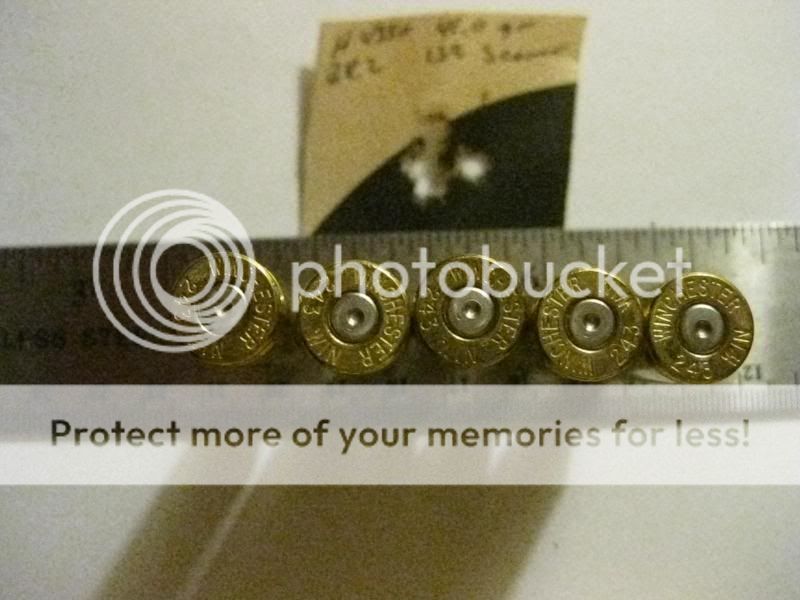

I used a laser bore site to get it on paper and just started firing. The point of aim was about 2 inches above and to the left of the point of impact.

I am shocked that the Surgeons firing pin is hitting that far of center.
Shouldn't be. It's kind of a result of fire forming to blow out the taper in the case. Fire forming of my 284 Shehane, and 375/338 Lapua Improved do the same. Those are on 1086R and Defiant deviant actions respectively. The 375/338 does it the least though.
What should be shocking is the accuracy... surprised me. All of them hammer on fire forming. (all chambered in house by Bartlein) So fire forming loads just turn into my intermediate and hunting loads.
