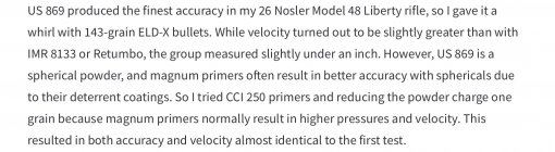

Threw some loads together with the us869 powder,don’t know the velocity but not to bad at 100 yards,Hornady 143 eldx
Barrel Break-In Chrono Data using 67 Grains US869 and 140 Grain Hornady SST bullets. US869 was all I had when I got my gun. These were slightly compressed loads. US869 is definately a slow crawler, but I can see my ES dropping and my MV creeping up as new barrel breaks in. Was getting 0.7 MOA on last groups and averaging around 2800 fps out of 26" barrel. I was also cleaning my barrel good between shot groups.09F94F7A-D2F9-4DA3-8A86-772998004547.jpeg
That ll work depending on your usage. Just remember that US869 is temperature sensitive and a warm/hot load in December will most likely be too hot in June through Sept ish ….!
That is such a slow powder I'm not sure you could even get enough US869 in a 6.5PRC case to make a hot load regardless of the ambient temperature.
