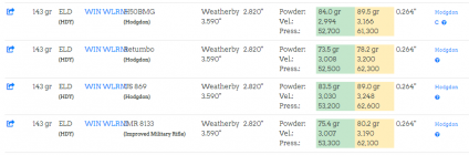

Anybody with loading experience for 6.5-300? Powders, bullets, oal s, etc.
Got R33 and US869 for starting point… 147 Eldm and 143 Eldx. Thinking the 143 might be a better choice due to thicker, tapered jacket.

In your situation, I found this listing for what you're asking about:
Like most reloading data, no one wants to venture outside the box by trying other bullets and other powders. They all test (or borrow) the same data for the same bullets and powders.
Now, somewhat contrary to these loads, I found that the 147 gr. and the A-Tips like the US869 while the 143, 140 Hornady and 135 A-Tip like Re-33. This is trying for a nearly full or full case, all using Magnum primers in my rifles, for colder weather.

I love Weatherby cartridges ,I have a 257 WBT that shoots bullet at the speed of light. BUT looking at your velocities , your less that a 100fps faster that what I can get out of my 6.5 PRC ,,,
If you take notice of that list you'll see that these are specifically FACTORY suggested loads as collected for this list. I use parts of this list when folks need a safe place to get started or find a middling ground. I rarely post my actual loads anymore. Too much misunderstanding of what's really happening without a complete and lengthy description of my process.
