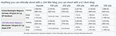

6.5 Creedmoor, 260 Rem., 6.5 Swede, 6.5-284 Norma are 6.5mm cartridges shown
Third from the left. Same case as the belted 264 Win. Mag. just left of it, but shortened to fit short-actions. Why didn't it take off? (Far left is 6.5-284 Norma. Far right 6.5 Creedmoor with 260 Rem. just left of it.
