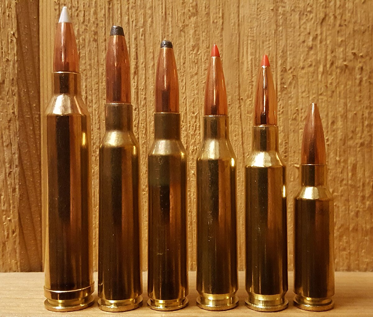

I'm seeing SMK Bullets that say Sierra Bullets 6.5mm (.264). Lapua Brass that says 6.5x47, 6.5x55, and 6.5 PRC.
I have just a regular 6.5 CM Rifle. What are all these variances?
I am starting to reload 222 Rem. I have found it useful to take a NOS 222Rem unfired cartridge and measure the hell out of it. And compare it to specs like OAL, neck dia etc. Hornady makes excellent 6.5 CM match that you could shoot and use as a starting point for your reloading specs. And get some high quality calipers. For sale here and on ebay. Mitutoyo and Starrett. You probably have calipers already.
Some of us that have been playing this reloading game for 50 or more years forget what it is like to be starting from a blank slate. I know I try to be gentle in these situations, but we assume a certain level of knowledge is present when it may or may not be.
People that are new to it without having a family history of involvement really are starting from a point many of us were in when our age was a single digit. Forums have replaced things like the old gun magazines we grew up with. Without a steady diet of articles extolling the latest and greatest cartridges in great detail, a lot of the language we speak is pretty obscure. The articles on the home page here are a great place to start one's education.
Simply different 6.5MM cartridges.
