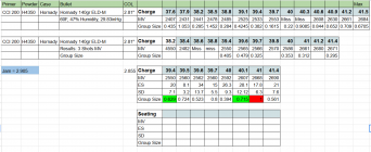

I'll preface this by I'm new to reloading and I like think I did my research but I just don't know where to go next. My rifle is a stock Ruger Precision Rifle, 24" 1-8 Barrel. I am using Hornady brass for these tests that was originally factory that I fired in this rifle only. As far as brass prep, I clean, Deprime, FL size with a .002 shoulder bump (from a fired case using a redding non bushing die), trim to 1.910, and chamfer/debur.
I did follow Erik Cortina's method for finding jam and measured that at 2.905, so I seated the bullets .02 off of that for 2.885 COL. I made this change after the first two rounds of load development. So I'm sure that could have some effect on my group size, but I was out for more details on MV, SD, ES on that third test because I didn't track those in the first two like an idiot.
The 39.4 load seems pretty promising it was very flat just a bit wide, same with the 40.1. The 41, I highlighted in red because I feel like I just shot terrible. The third test was also 5 shot groups instead of 3.
The ultimate goal for this load is 1000+ Yards. I'm not really sure where to go next. I have zero signs of pressure and the brass has been fired 4 times. I was contemplating between trying seating depths on some of the low SD nodes or seeing about going higher in charge to get closer to 2750 MV. I'm concerned about the velocities knowing I want to go out to 1000 or more. From my ballistics app the 39.4 should still be 1300fps at 1000 but it makes me nervous with my limited knowledge. Hornady has 41.5 listed as the max for this bullet and their cases.
Appreciate any insight you all have. I also have 100 factory new Hornady brass that i could load up and completely restart if you all think its a good idea.

Forgive me if this is a dumb question but are you suggesting to just pick the 41.5gr load and shoot it at longer distances. I was trying to get a get a load ready that was accurate and consistent at 100, then work on Dope out to 1k. I have not taken it out to distance yet just because the 1k range is 3 hours from me and I wanted a load first to really test. I also can't read the wind yet, which I'm well aware of lol so lots of practice is in the cards but I was always planning to do it with my load for this rifle, but maybe that's stupid though.

I know that, I found my jam point and went .02 back. I don't think it likes being that close to the rifling though and will eventually do a bullet seating depth test when I find my charge weight. I'm not in the rifling and everything chambers and ejects fine. I have zero pressure signs or any issues with the cases after firing. from everything I have read that is perfectly safe as long as I'm watching for all the signs.
I like your idea of just finding the ideal seating depth before going back to charges. I think I will do that.

Yes, I would load up some at 41.5 and 41.4 and maybe 41.6. The 41.4 load was best but I would not put my faith in that at this point. 100 yards is just a starting point. At 300 yards some loads will give the same groups at 300 as they do at 100. And some will be 3" groups. 41.5 is a wide node. You can fine tune it later. The 40. grain load is accurate also. But you want velocity if you are going out to 1000 yards. I also have the same rifle you have and it is a great factory rifle. A great place to start. Shooting at longer ranges is going to make you a better shot because you have to work harder on your techniques. A 3 hr. drive is a long way. I would plan on spending the day and take my cleaning kit with me and shoot as much as I could so you can see what happens at 300 yards with those loads. Also, with that chamber, 147 gr ELD bullets will shoot just fine at 1000 yards with. .015- .020 off the lands or mag. length. Same with the Sierra bullets. Or Hornady 130 gr. ELD bullets at 2.800". Those bullets will be very accurate in that rifle. You also need a sled magazine that will allow you to single load longer bullets at some point. I would start with Hornady 130 GR ELD bullets at 2.800" Mag. Length. They are very forgiving.
