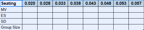

I ordered one box of Lapua LRP brass today since I have a few thousand primers. I will order some SRP ones next time I get no hazmat and pick up primers and powder. I did all my seating last night this is what I ended up with. Worked .005 back each time except for the first which was .02 back, then I over seated the first round. My variance was usually within .001 occasionally getting a +- .001 but I still that is very consistent from what I'm reading so my process seems pretty stable.
Here is what I plan to shoot:

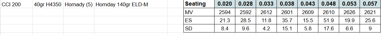

Here are todays results: My question becomes when I get the lapua brass do I load a bunch at .043 from jam and different charge weights, Do I re-run this test. I'm changing a pretty big variable in brass and it won't be fire formed at all yet. I'm also eyeing the .053 as I'm pretty sure that low left round was me.
It looks like you are seeing which depths scatter and which ones shrink which is great!
I see you tested .005 differences in depth. I might suggest reshooting groups again with your successful depths of .043 and .053 if you called that flyer and additionally would load some -.003 and +.003 from both depths you found success. The results you find from this confirmation will help indicate how wide and forgiving each of those depths are and what is acceptable to your accuracy standards.
