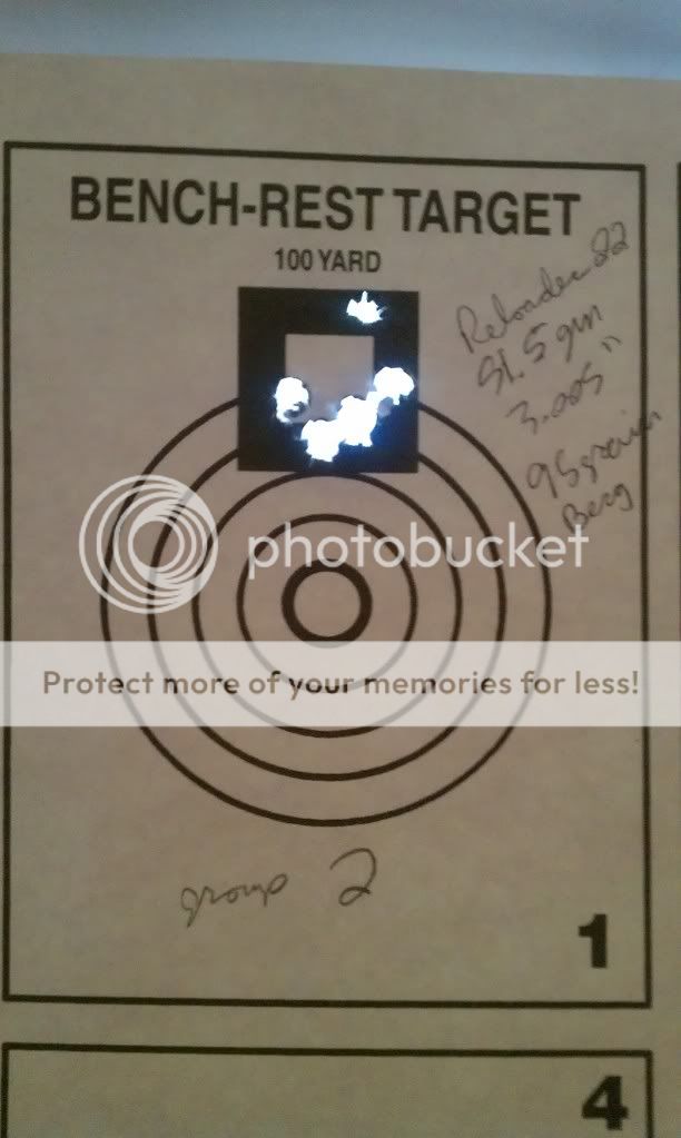

the first pic is the best group i could get, but there was loading problems so i will not be shooting that load.
The first thing I would do is bed the rifle. I am not saying non bedded rifles will not shoot because they can but if I have problems that is the first thing I do. You would need a 6.5 or 25cal Neck Sizer die to bring it from 284 down to 25 than you would use your full length die to bring it down to 6mm. I bought a redding 6mm284 neck die that brings them down to 25 but you could just try any 6.5 or 25cal neck die and see if that would work just run the case through the die just to size the neck and not touch the shoulder. I do not know about the 100gr bullets you are shooting but the 95 Berger group looks about like what I have been getting in anything I try them in. That caliber and case are one of the most accurate I have ever seen so if you have a good barrel, bedding and chamber job it should shoot. Have you checked your scope or changed scopes and made sure your bases and rings are tight? That has bit me more than once when I had something lose or the scope was bad.
