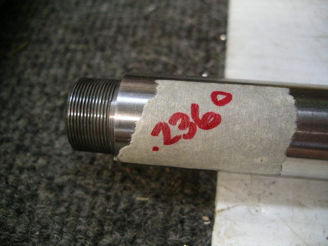

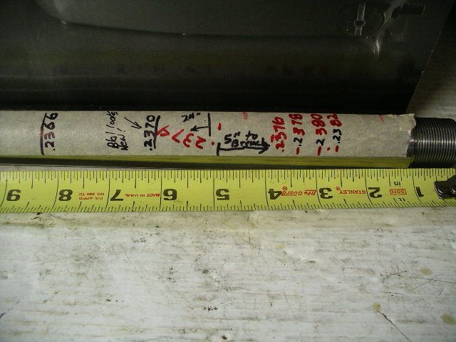

I have posted this previously, determine bore dia at the muzzle.
Now, cut off enough to locate the new throat at the same dia as the muzzle: GOOD LUCK!
Couple of issues with Set Backs. One is the steel maybe work hardened and chip/dull the flutes in the leade angle, throat, neck that already takes a beating. Flame and cleaning rod makes for a somewhat difficult job dialing in the barrel if you do not find the spot where the bore dia matches the muzzle dia. Otherwise, you can have great results.
You take the risk of a ruined reamer that leaves rings where carbon or hardness chips the reamer. If there is any hard carbon in the throat, just don't set it back.
I don't care if the breech end is larger than the muzzle end. Other way around is a problem.
I understand the setback is hard on the reamer. For my FTR barrels, I got two reamers. One for new barrels, one for setbacks. If the setback reamer gets banged up, cost of doing business and getting another couple hundred rounds on the barrel.
