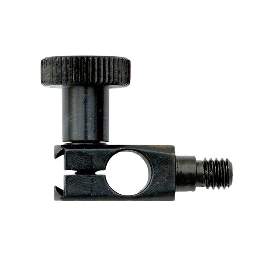

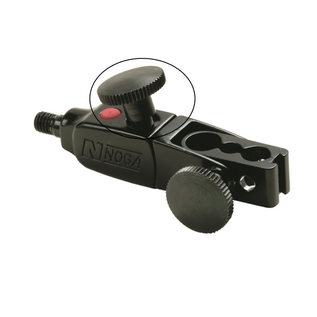

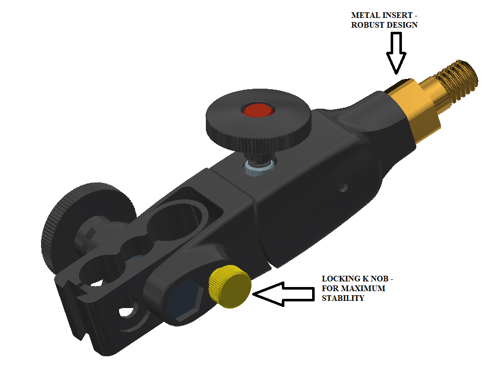

However all I use for anything else is NOGA. The fine adjust on me arm for dial indicators and the fine adjust on the base for test indicators and .0001 resolution stuff

Rigidity is fine and I’d say no different with either adjustment type. You can actually buy them with both adjustment types on the same stand if you want. They work fine for either type indicator and the heads are setup for both. Be advised the heads come in two standards on the base adjust models. One head is euro and the other is US. Euro is 8mm and 1/4” dovetail, US is 3/8” and 1/4” dovetail. You can buy the clamps separately so you can swap them out if needed. On the top adjust the heads are setup for 6mm, 8mm, 3/8" stems and 1/4" dovetail.
Edit: Once I got out in the shop I realized the top adjust models were setup for 6mm, 8mm, 3/8" stems and 1/4" dovetail.
The Noga guys are right. I bought a Shars since I was ordering some boring bars…it’s not even in the same league as the Noga.
