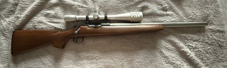

Recently bought a nice 40XBR in .222 and looking for load suggestions to start with. I have some IMR4198 and BLC(2). Bullets range from 50gr vmax to 52gr SMK.
Try a Hornady 50 grain SP. Built to stabalize in a 14 twist. Same with the Sierra 50 grain SP. Old scholl bullets work in old school rifles
I built a 40XBR clone last year. Used original stock as a pattern. Mack Bros action, Bartlein 1-12” barrel. It shoots crazy good with Berger 52s and H322. I tested all the go-to powders for 222. All gave great accuracy. H322 won only due to having 8 lb jug already.
Absolutely beautiful
While not a 40XBR it is a 222 and it deserved a trip to the range, I had forgotten that I had switched the Redfield 3200 to another rifle and put this 16x 6400 on the 222. Once I final tightened the scope ring caps and got her zeroed she liked the Sierra 52 hpbt but think I will try some Barts or BIBs and see just how good it gets.
