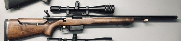

It’s a standard rem 700 short action footprint, here is a rem 700 SA I put into a old 40x stock that I gussied up. View attachment 1242849
Thanks for confirming! That's a nice looking rig! Just ordered a GRS Berserk stock and will make appropriate mods once it gets here to make everything work. Any comments on the AICS box mag conversions of existing 40x actions? Not a necessity but saw them while searching and thought it was an interesting idea.
