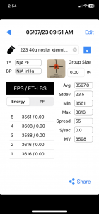

Well happy to report I think the xterminator was a winner with max book charge and had zero pressure signs. I even loaded a couple over max to see if I got signs and was good.
I have a cds scope on the rifle and might send in for my dial now that found a load. IMG_1117.jpegIMG_1120.png
