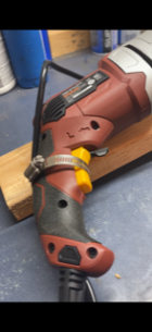

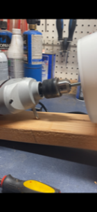

I ordered a National Metallic Tumbler online. Backordered! So I canceled the order. I made my own.
Picked up a 1/2 inch, 9amp drill for $19.99 and 2 casters from Harbor Freight.
Already had 2 2 gallon buckets and lid, a 5/16 bolt, a hose clamp, and 2x4s.
Drilled hole in center of bucket for a bolt to the drill. I put three strips of wood in the second buckets for more tumbling action. I used a bolt to prop drill up at an angle. Hose clamp on the trigger for speed control.
Runs great but I have not tried it with brass and pins yet.
