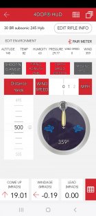

Pop the numbers into your calculator.
There is a huge elevation difference at 500yds from the 8tw to the 10tw.
I thought it was wrong so I tried other calculators and got pretty much the same thing
8 twist.
10 twist.
Edited.
I posted the wrong image above. Removed and replaced it to represent 10tw at 500 yards, not 8tw at 700
