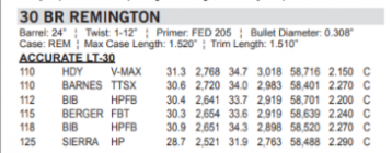

I tried these as well with 30.0 Gr. AA-LT-30 and CCI BR-4. My 5 shot group was .338 Probably won't bother with them again.
I'd be surprised if they won't do quite a bit better with more testing and maybe a more appropriate load. Yours seems pretty light and it's just one group. I wouldn't judge any bullet by a single group. As with anything, more testing will show more data. Your barrel may never shoot them well but for $24/100, if you can find them, they are surprisingly good. As I said in the previous post, I don't compete with them because I don't trust them to be competitive with customs through a 1 or 2 yardage agg. But I've seen them shoot well enough to do in a pinch. I'd add some powder to that load. It's likely about 4 or 5 grains light. A load that far off that still shot in the low .3s might just have potential but yes, it's got a long way to go.

Yea, AA load data show 31.9 as MAX for the 125 Sierra with a bearing surface .391 and the 125 Speer's bearing surface is .287 so it could stand more powder.

I'm not advocating for loading dangerously hot but I'm not sure anybody at a match is loading by book data. You have to do what is within you ability to read pressures and what you are comfortable with. But hell, I dont think I have even seen a 30 br in a Reloading manual before. I've got maybe a dozen but they' range in age from 5 or 6years to about 20 years old.
It's still a wildcat so I kinda figure that you're on your own anyway, as there are no saami chamber or pressure specs, that I'm aware of. I'm speaking purely from experience, not what I've read online or in a manual. Ymmv.

Accurate Arms & Sierra have the 30BR listed in their manuals but I have not seen it anywhere else.
Sierra list bullet weights from 110 gr. to 190 gr. in their VI Edition.
