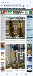

Also, how far down into the shoulder do I go? I'm seeing some conflicting information on this part. I've been watching videos and reading quite a bit. I saw this picture on the accurate shooter website. And then I watched a video on PMA and saw the picture posted. My cutter is a 30 degree angle. Is something like this inevitable. How far down do you go? Ill probably end up doing 1 or 2 and post on here for criticism.

The good thing about pushing the shoulder back is that the bottom of the cut becomes the 'blend' into the shoulder when the case shoulder blows forward. For a cutter, one with more angle than the exact angle of the shoulder helps eliminate an edge that can occur. For the BR case, I find a 35 degree cutter works well. The more runout there is in the expanded necks, the more wobbly your blend cut into the shoulder will appear. The way the Parosky cases look is the amount of blend I like to see. A carbide turning mandrel is a huge help, too.

Do you think you could accomplish parosky's cut with a 30 degree cutter, or should I really have a 35 degree? If so I'll just exchange the ones I have.
