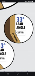

I have a question about the cutter angle. The 6BR shoulder is 30 degrees. In the case of K & M they don't offer a 30 degree cutter. Should I be using a 33 degree cutter after I have expanded to 30 cal?
Thanks!
I've never lost a neck from cutting into the shoulder, I was hoping for @RGRobinett to shed some light on his opinion.
