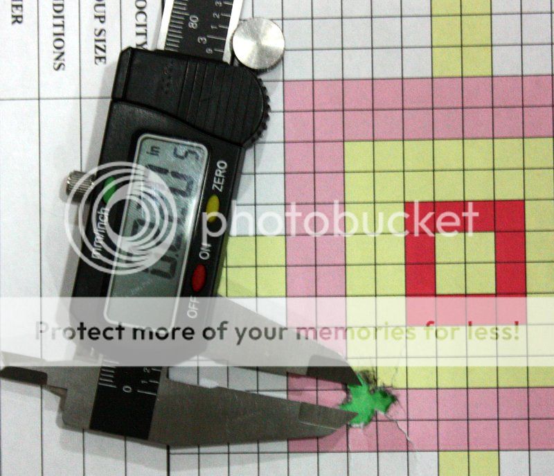

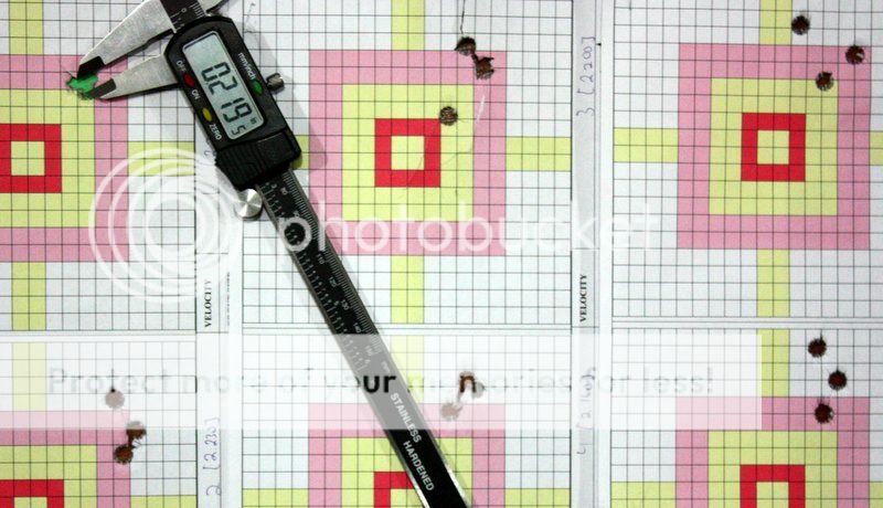

Tried Varget, 4064, CFE 223, Benchmark, H322 and I found that none compared to IMR 8208 XBR for consistency, plus temp insensitive. It's my go to powder! A little pic of a load dev I did for a friend's Savage Palma with 8208 XBR, 155 Amax ;)
Needless to say, he was impressed...almost 1/5 MOA at 100m :)
