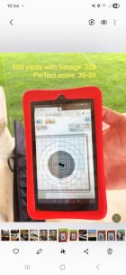

Not entirely relevant to your interests, but my Savage .308 likes N150 as well with 167g Scenars. This is .67 MOA at 600 yards with them a few summers ago.
