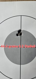

I just got done shooting. Got my hands on some 6.5Staball over the weekend from one of my brothers. I loaded up 7 rounds with 215 bergers with 7 different charge weights to see where pressure started. I didn't see pressure anywhere and all 7 shots were in a cluster that showed .75" vertical. Debating on whether to load some up and test for groups and check velocity or do some H4350
Shot 2 five shot groups today before heading out for work with the 6.5Staball loads. The wind was absolutely atrocious, but realistically the only thing it effected was paper target it caused to move around. 25-35 mph was a chore but, the last load shot pretty decent. 5 shots into .75. I will do some more testing with this powder as I think i can shrink that group and will try my H4350 and Accurate 4350 next.
215 grain berger hybrid. I haven't chronographed that load yet, but based on the previous lighter charges, it is in the neighborhood of 2400-2410 fps

Going to jump in before XTR answers. I think varget and N150 are a tad too fast for 215s. I'm testing 6.5 StaBall now and will try one of the 4350 flavors also
Acyr, i guess I should have answered a little different. It depends on what best results would be defined as. Pure accuracy, speed, or a combination of both? I did get terrific accuracy with N150 and 215s, but I saw pressure before I liked with those loads. I'm not done with N150, as I will try that when I get some 200s.

I just got back from the Rocky Mountains this morning and went out and chronographed that load after I woke up. Surprisingly, this charge was slightly slower than the previous lower powder charge by 6 fps. Had an average of 2376 fps. Not sure what to make of it.
