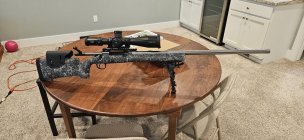

Well, i finally got my barrel after about a 19 week wait. Ordered from northland shooter supply....what a great company, ordered several from them. Anyhow, barrel is a criterion 8" twist with MTU contour and finished at 28" and has the .308 win F/TR chamber. I plan on shooting nothing but 200-230 grain bullets loaded long since I put this on a remington 700 L/A. Was thinking either some N150 or H4350 for powder. Anyone else here recommend anything else? Thanks
