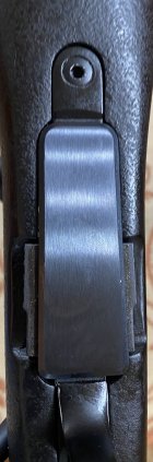

Remington’s detachable box wasn’t extremely popular IMO, at least I don’t see it much. The stock needs to be relieved for the box’s inset and integral release buttons.
Most bottom metal handles the securing and release of the box but Remington put that feature in the box itself.
This bedding job is so tight so as to discourage unnecessary removal, and I simply take at his word, my bedder’s assurance that it can be removed.
This is one of those guns where a bunch of components that were not actually very expensive or “special” at the time, can be assembled in a way to be one of those permanent “keepers” that I’d rely on as implicitly as their “betters” in the most important instances.
