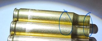

There are a couple other things that might indicate a chamber problem. One may be a loading problem worth looking at.
There are other marks on the that look more like gouges than being tight. But the main one is the case mouth.
If that recess at the opening was not there before chambering, either the brass is really long, or chamber is short.
If it was there before, the. There may be a die problem or you have an excessive crimp.
Certainly worth looking at some loaded rounds and checking.

yes, these were a little too crimped! but, notice the total scraping line around the circumference toward the back of the case! and some longitudinal ones along the case...none of that was there before the cases were inserted in the chamber...take other clean shells, same batch, put in my savage 10, no issues, came out perfectly clean...i will have to wait several weeks to get the gun back and see what savage says...

Based on the pictures, my guess is that the mouth of the chamber was not chamfered correctly and there is a sharp edge. That is what is causing the scratches. Add in the fact that the fired brass you are using is a bit big just in front of the 0.200 line and you get what you see on your brass. That is very easily fixed if you want to do it yourself or have your gunsmith do it. Of course, once you start using brass for that gun exclusively, it should reduce to the point where it isn't significant.
