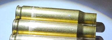

Pic of catridges with scatches:
These were clean going in, caused bold to jam, had to bang hard to release.
I have a savage 10, used same cartridges, loads ejects smoorth as silk.
These cartridges are well within spec.
you can clearly see the scratches, which I think were where the cartridge was getting lodged cause the bolt issue. Something is wrong!

Those case definitely look like they're being jammed into a chamber that's too small. Or . . . the cases are too large, which can happen if these are cases that were fired in another rifle, even though they're been sized. The case might need to be sized with a die that's a "Small Base Sizing Die"???
What measurement to you get for the diameter at th web, like at the .200" area? And what at that area where they're being scratched?
The chamber is ugly and should never have left the factory. You are right to send it back. It could be set back a turn and fixed, but you should not have to pay for it. There are several technical terms often used to describe a chamber like that, but none are suitable for a family oriented site. WH

That .470" is right at what my fired cases come out to be. After sizing, my cases are at .4690". Your "0.47" should still fit any SAAMI speck chamber. Guess we'll see what you get back from Savage. ¯\_(ツ)_/¯

Yeah, I think .001 can make a difference in a chamber like that. But it still just seems like a pretty tight chamber for a factory gun. Maybe they were just using a brand new an old well used reamer with your barrel??? ;) :p
Yeah, I think .001 can make a difference in a chamber like that. But it still just seems like a pretty tight chamber for a factory gun. Maybe they were just using a brand new reamer with your barrel??? ;) :p
It would actually be using a worn out reamer because as the reamer wears, its outside diameter diminishes and the chamber becomes more and more tight. Headspace gauges are much smaller in diameter than the body area of the chamber. The headspace gauge is only used to measure the distance from the bolt face to the datum line of the shoulder. When I chamber a barrel I always insert a new brass cartridge case to ensure that the reamer body is still within spec. Reamers can be ground sharp again and this restores the true chamber dimensions. Typically a chamber finish reamer can finalize many barrel chambers but have to be maintained. Apparently your chamber was finalized with an out of service limit reamer. Honing the body portion of the chamber could fix the problem but chamber will never be precise enough if reloading is in the plan. Factory ammunition that’s being discarded. Full length resizing would probably require excessive shoulder bump to get the body diameter undersized enough for the brass to drop out when confirming case to chamber fit.

A quick look at the chamber with a bore scope would have likely confirmed it but I really believe (and have seen it before) a chip (or 3) got on top of the reamer and scored the chamber. Such an issue would cause those "rings" on the brass. You may have noticed it difficult to chamber a round and close the bolt and you definitely should have had trouble with ejection of spent brass.
I'm betting your rifle comes home with a new barrel.
