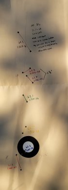

I took my 80 round barrel down to deep creek also. The Friday seating ladder in my typical jump zone for my bullet looked good. The Saturday target spit 1 bad low shot to ruin a target, but Sunday she did respectable. I preloaded at 63.835gr h4350, and it sped up yet again, so will have to come back to powder. It's all pointless sort of since eventually this 200 count will all be fire formed, and I'll have to start over lol.

The adg shoots pretty decent, with the occasional dumb shot while fire forming. Was out today to see if I could manipulate my 201 into doing better or worse with some meplat work. Fire forming the last of my brass in the low node this time. A heads up, you will want your rifle in hand, and will likely have to bump the longer cases. It wasn't so hot in that dimension and needed corrected.
Tom
View attachment 1460626View attachment 1460627

That's sweet!
Hoover tools?
