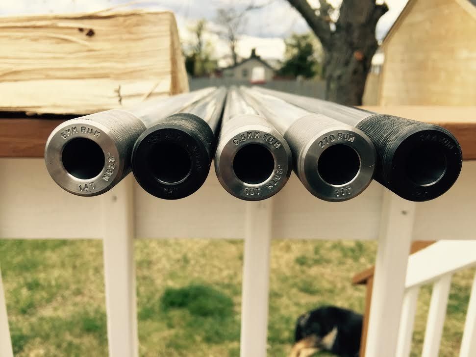

By Far I love my Remington Ultra Mags the most, if you want to get your blood pumping this how. well for me anyways.
from left to right.
6mm, 257, 6.5, 270, 7mm, 30, 338, 358, 375, 416, 458, 500.
