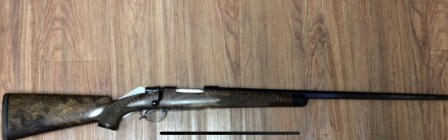

Here are a couple pics of the original rifle. $1400 is why I am asking the question. Under 1,000 I would have already bought it. I have custom rifles in stainless and synthetic stocks and they shoot lights out. But I also like the mausers in a fine piece of wood.

The only thing I'd be concerned about would be will it feed the .416? The Mauser feeds off the rails. If the rails have been 'opened' to feed the .300UM, will it still feed the .416? Many, many '98s, both commercial models and military models, have been altered for the H&H cartridges over the years. And it all depends on how the alteration were made. I still build case hardened Mausers in wood, but I pretty much stick to standard cartridges (.30/06 , .308 , X 57 , 9.3 x 62 and std. length mags) and I have them re-carburized before I use 'um. Zastava offered their commercial Mauser in .375 H&H, but I think those Zastava actions were forged of alloy steel and 'through hardened' (not certain of that, though). Nice stock on that .300UM, though. A case hardened Mauser wouldn't be my first choice for a long magnum. Lots of metal to remove to 'get there'. $1400 is a low price for what is seen in those pics. Couldn't build one from 'scratch' for that.........

FN would have a specific logo on bolt handle and made in Belgium .
The bolt stop looks Spanish but the contour on the rear tang looks CZ .
Hard to tell from the pictures . The only one very questionable is the spanish and of course how much was remove from the locking lugs , specifically the lower .
