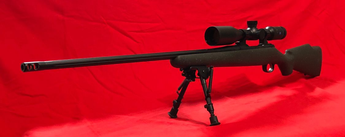

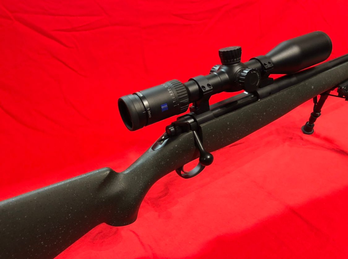

Between Frank Green, Dave Tooley and some advertising from Hornady I was persuaded to build a 300 PRC....actually Ive built 2, first one had a Hells Canyon CF Barrel which is cool but not really what I wanted but my gunsmith says you have the barrel and a donor rifle lets build one, so I ordered a reamer....!
well it turned out awesome and was extremely accurate with any bullet I put through it, my nephew bought it from me so I built another almost identical aside from the barrel, I went with a 26" #4 fluted Benchmark 1-9.5 twist
So far its been a dream to shoot, after sighting it in with the factory 225gr ELD-M I tried some handloads with 76grs of R26 and everything shot from 1/2" to 3/4"
I shot it at 500, 650,720 and 820 yards with my gunsmith spotting for me, I shot a 3" group at 820 yards, I have never shot that far in my life and my gunsmith lifts his head out of the spotting scope and says.....WOW I need one of those !
And Im certainly no F-Class shooter......I shoot recreationally more than most but thats where it ends, so I can't say if its better than any other 30 cal magnum but it certainly impresses me.
Kimber Montana 8400 300 PRC (300wm) donor, 26" #4 Fluted Benchmark 1-9.5 twist, Zeiss V6 5-30x50
