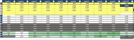

After 250 rounds the barrel I meticulously prepared the 2x fired brass for consistent neck tension.
Ran a ocw from 77.2 to 80.8 in 0.3 increments.
What I see is that the obt node in QL is 1.430ms which was giving me consistent POI from 77.8 to 78.1 in 3 different range days around 2850fps
After I ran this test yesterday I see some differences in Poi and I don’t know what the heck happened to 77.8. It might be me?!
CCI BR2
15thou off
55deg morning
77.2 2815fps
77.5 2837fps
77.8 2851fps
78.1 2857fps
78.4 2880fps
78.7 2886fps
79.0 2903fps
79.3 2910fps
79.6. 2915fps
79.9 2931fps
80.2 2947fps
80.5 2963fps
80.8 2969fps
At 80.2 bolt was heavy but nothing that scares me.
I ran a seating depth test at 79.3 and didn’t like it at all.
What do you guys think about running in the middle of 79.4-78.7?
POI is similar
Velocity is flattened with ES of 8
