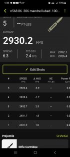

Been testing new loads for my 300 norma improved and decided to try some loads at .100 off just to see because I seen where guys were saying better results and more consistent ect.
Berger 245 lrht .100 off
N568 86 grains
5 shot group
Correction they are .130 total off I took .100 off from my .030 number which that's where I usually run my 245s

I run 89.5 N568 under a 245 LRTH / 26 in barrel / just over 2900 fps. Averages .0036 throat death per 100 rounds.
That's really good. I've been running 87 grains 2925 avg in 30inch. Me and a few others have been running 87 and all of us seen pressure at 89 grains. The throat seems really good I like n568 for barrel life what are you guessing your going to get for barrel life?
I don't know yet. There are a lot of variables that go into the barrel life question. For me barrel life for ELR is dictated primarily by the obvious (accuracy and velocity loss) but also BC degradation.
