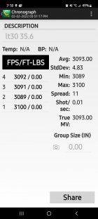

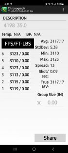

30 br chronographed with LT30 compared to H 4198

Looks like tune to me. Close, but not quite there. JMO...with the lt30. Pretty big steps in powder charge when you look to be very close, in between. Again, JMHO.
What does the shot 0.09 sec mean ?
I had already shot the LT 30 and came up with those loads to test again for accuracy . That's why there is such a jump in between loads.
This is the 1st time I've used a chronograph.
Getting more powder in them i's going to be hard. Crush crush with 35.6.Screenshot_20220203-191855_Chronograph.jpg
ppl Only one is marked 4198.
The other 3 (no powder make written) is lt30.
Thread title is 30br LT 30 compared to 4198. Again only one 4198 to compare the LT 30's to
