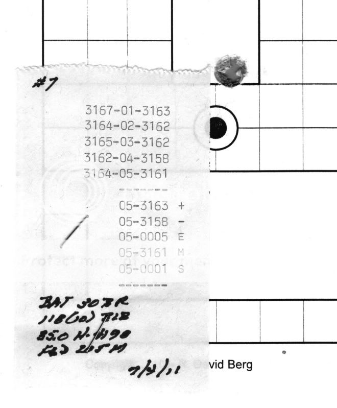

A 28" barrel works fine. You'll get significantly higher velocity than with a shorter barrel. Mine run around 3150 fps.

After a goodly number of rounds I set the barrel back and also cut 0.3" off the muzzle end. 28", 26.5" and 25" all shoot the same except for a drop in velocity. Requires some re-tuning.
