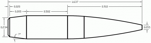

Eric Stecker stated that the estimated B.C. was G7 .406, a bit ahead of the 230 Hybrid and with less recoil. It could indeed be a game changer. [br]
http://www.longrangehunting.com/forums/f19/berger-introduce-7mm-195-gr-eol-hybrid-hunting-bullet-85792/ [br]
Attached is a drawing that Bryan released.
Would you still put this new bullet on a .280 AI or move up to a magnum for more speed? If you get 2900-3000 from a 180 in AI, might need that extra speed. The barrel I ordered is a 1:9, so I don't think that will work. Need 1:8?
