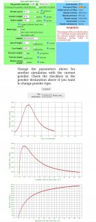

I do have GRT and can run some numbers for you tonight after work if you want to see what the OBT node might be. I would need your case volume (gr/h2o) COAL, bullet and exact measured velocity for a given charge of N160 to calibrate for your lot. Lmk.
Thank you very much.
55.78gr h2o,
2.963" coal,
Barnes 140gr Matchburner, 1.345" length,
44.5gr n160 2755fps, 14 ES, 6 SD (Labradar).
I HBN my bullets, not sure how much HBN affects pressure compared to naked bullets.
@46and2
Here is the entered specs:
Bullet resistance is set to negative to tune your measured velocity to match your powder charge, which makes sense with HBN coated bullets.
Here is calculated output matching your velocity:
This is calculated OBT showing adjusted charge and node #5:
This is the next half-node up #4-1/2 (more powder) and adjusted charge and calculated velocity:
I'm on vacation in TN so I didn't bring my labradar. No pressure on my Lapua brass. May go to 47.8gr of n160. 11650.jpeg
GRT Did show the next OBT node for your load as 46.95gr. If you're still good on pressure, I'd sneak up to 47gr and see what it looks like.

Predicted velocity was 2913fps. I'd be curious to see what it is when you finally get to chrono it. Cool to see nice groups matching up with the predictions!
