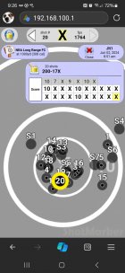

Here's what I mean . . .
Shots 1, 5 and 15 were wind calls. Missing the X-ring was absolutely on me. Better wind calls would have resulted in a 200-20X. I was shooting Berger 180 gr. Hybrids, and these bullets gave me a vertical spread well within the x-ring. Nosler 185 gr. RDFs would not have yielded the same result at 1K. Heck, the 600-yard targets I've shot with the RDFs didn't look this good. None of them. I'd drop points above and below the 10-ring, right side and left side, on consecutive shots with the same conditions, and not just 9s. Some would fly into the 8-ring or 7-ring, above or below the 10-ring.
I've seen this enough to conclude that my ability to read conditions is not the culprit. The RDFs just don't shoot as good as they look.
