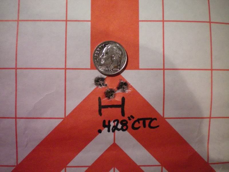

Shooting TC Encore Pistol with 15in MGM barrel.
Shooting 100 gr. hornady sp over 45.5grs H414 and getting .25 groups at 100
Shooting 129gr. hornady sst over 43 grs H414 and getting less than .5 groups at 100
also having great results with the new 123gr sst hornady recently put out for the creedmoore getting less than .75 groups but still playing with load. last one was best to date using 44grs H414. less than .75 but wasn't having a good day shooting so going to try again and see if I can do better.
