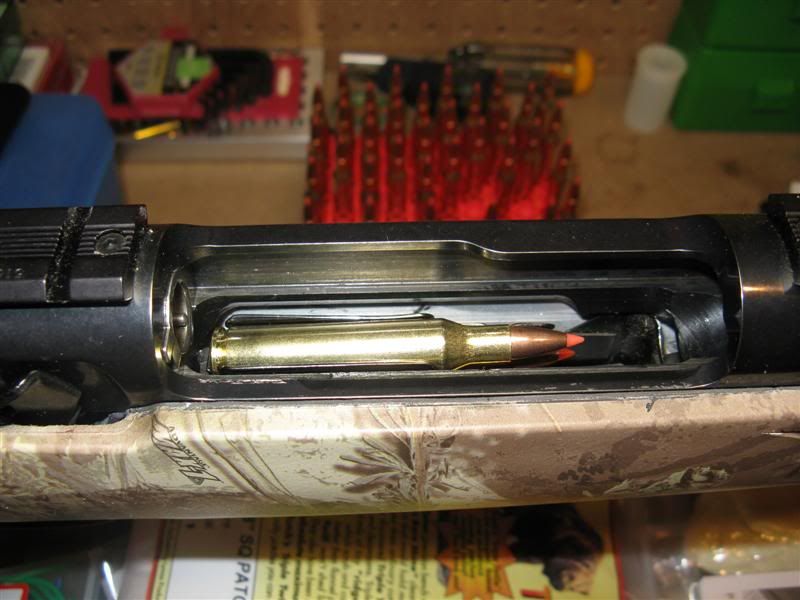

This is what it started out as, a Model 111 270.
Sitting on my messy bench.
I went with the long action just in case I wanted to swap barrels down the road and needed one. I haven't had any feeding issues so I guess it's OK.
