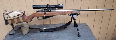

Since this thread started, I built a couple 25 Krag Ackley rifles:
1) Low pressure in a Krag action.... ok, but Ackley formed cases will not feed. Need the shoulders reduced a few thousands.
2) High pressure in a Mosin action.... spit shoulders on the cases, but the buck died.
