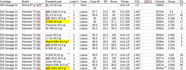

I've done extensive testing in my 250ai. Here are just a few powders and loads tested in my rifle and as you can see the cartridge is capable of excellent accuracy. Never did find max loads with the hammer bullet.
