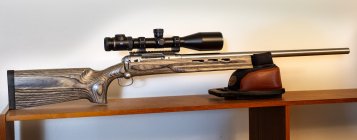

Well, I got to Ben Avery today but had a few problems.. First, the scope I was using, a very expensive Zeiss, couldn't be adjusted down enough to overcome the 20MOA rail I was using, so siting was 'difficult', and then the Winchester factory loads I bought chambered so difficultly that I coudn't shoot them, so I went home.. FWIW, my handloads worked just finely.. Couldn't find ANYWHERE a 'flat' scope rail, but I discovered that a different Zeiss scope with more elevation range could be screwed down far enough (I think) so I mounted that.
Also tweaked the headspacing a little and all the ammo now fits and the no-go headspace gage 'no-gos'.. Never even got to see if my LabRADAR still works.. Going back tomorrow morn.

You sure you don't have a zero stop enabled on the first Zeiss ?
There's nothing in the Instructions about a zero-stop, so I disassembled the top turret and found nothing that looks like an artificial or adjustable rotational stop to me.. But I reinstalled the Zeiss 4.8-35, and next time to the range, I'll also bring the 4-12X.. I also ordered two flat rails from EGW, thx to std7mag.. The Savage 12 Benchrest Rifle is a single-shot, dual-port, round-top action with a 3.9n" screw-centerspan.
Google Zeiss Victory V8 zero stop, those scopes do come with a feature to "lock the turret" or set a zero stop
