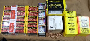

I'm back, sort of.. The shoulder surgery was succesful and just this week I got cleared to start shooting again.. BUT...I've turned into a fotografer again* and am enjoying that.. Meanwhile, lots of those 'vaporware' bullets turned real during my convalescence...
(I didn't intend to order so many Berger hunting bullets, but that's what happens when they take months to arrive AND one forgets what he has ordered. )
I'll get my rifle together in a month or two--the barrel FINALLY arrived a few weeks ago--and we'll see what happens.

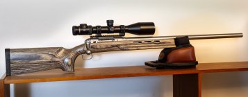

Mounted the scope, a Zeiss V8 4.8-35X60 with 36mm tube. The 60mm objective lens and the 36mm tube diameter are the largest I've seen in a sporting scope. The front threads are filled with a 62mm Zeiss T* lens filter.. I'll do anything to avoid doing anything useful!
Left-arm carpal-tunnel-wrist and ulnar-nerve elbow-and-wrist surgery is tomorrow at 6:30AM
(YUK!!!!!!!!!!!!!!!!!!!!!!!!!), so I won't be shooting this for at least a month.. But that's probably OK, because it'll take about that long to remember how to load rifle cartridges.
