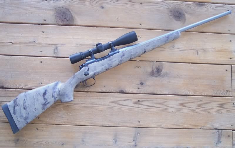

My .25 is a 250 Savage Ackley Improved. It has mild recoil and is very, very accurate. With the BIB .25's it's scary accurate for a hunting rig. The Sierra 87's are a killer bullet for a combo coyote/deer gun. I can't make it shoot bigger than 1/2" three shot groups with powders from H322 to WW760. ;)
If I was to build it again at this point in time, I'd opt for the 25X47 Lapua. Excellent brass and simplified dies make the 25X47 Lapua a great choice.

What is the barrel length on your rifle, Al?
