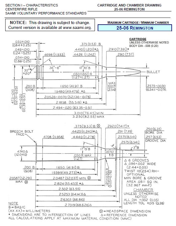

Added piece - I did some case gauging using the Hornady headspace comparator set. I tested factory loaded rounds from Hornady, Remington, and Winchester. The numbers of those factory rounds are as follows
Hornady 2.041, Remington 2.043, Winchester 2.041.
I found some fired cases and these are the numbers as a batch prior to sizing:
2.055, 2.055, 2.052, 2.050
The same cases after sizing:
2.040, 2.039, 2.040, 2.038

There’s a place to start, way to short at the shoulder. Factory ammo is generally at minimum, or below SAAMI, you are sizing to shorter than that. .015” is a lot of stretch.
Almost like you bumped the shoulder back .002” from original, instead of fired length. Instead of fitting to the chamber.
A quick look at the drawings and minimum would be 2.0456 at .375” diameter on the shoulder.

Yeah, I see it, and agree. Man o man it is always the little things that will kill ya. I had the information right there in front of me the whole time and it just never made it past the skull. Well, I shall go back the bench and re-think my inks. Super appreciative of this.
Be aware that likely your comparator numbers are not an actual measurement like the SAAMI drawings. In no way would I setup a sizing die based on matching SAAMI measurements to comparator "measurement".
