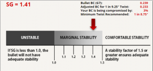

What twist is your rifle? From what I've read, and Berger's calculator confirms this, is my twist rate is on the bubble for this bullet. Works for some, but not for others..

Try the 87 Grain Berger HVLD'S as, they WILL,. "stabilize" even, in a 1-10 Twist.

I bought a 243 Rem 700 Varmint (1:9) and shot it for the first time earlier today. Went with IMR 4350, CCI 250 and Berger 87 VLD. All 5-shot groups at 100 yds -- 39.0, 39.5, 40.0, 40.2 and 40.4, in that order from upper left. Scope on 25x. Breezy enough that most of the time I was having to wait for the wind to quit moving my target backer around before I could shoot.
Looks like around 40.4 is where I will need to be with that bullet. Wasn't far into the case as I wanted to start with very little jump.
I shoot the 95 VLDs in my Rem 700 with the same twist. They shoot awesome. I tried the 105s but no luck. The 95s will do fine on your barrel. I can't offer any load data as I only use H4831sc in mine. Excellent groups for sure at around 3150 fps. Good luck.
