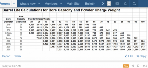

Two trains of thought , one balls to the wall 105-108s 3150 fps., barrel life is 1000- 1500 rounds, two keep your loads at 3000-3050 fps., barrel life 1600-2300 rounds if your lucky. No 20-25 round strings of fire.
Heat and pressure are not your friend. Slow powders long barrels extend barrel life.
If you want a better mouse trap in 6mm look at the 6mmBRX or 6mm Dasher. 10-17 grains less powder and twice the barrel life. Just as good or better performance.
Nat Lambeth
