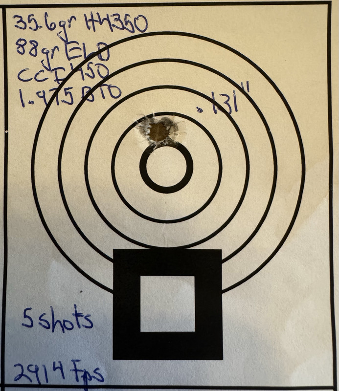

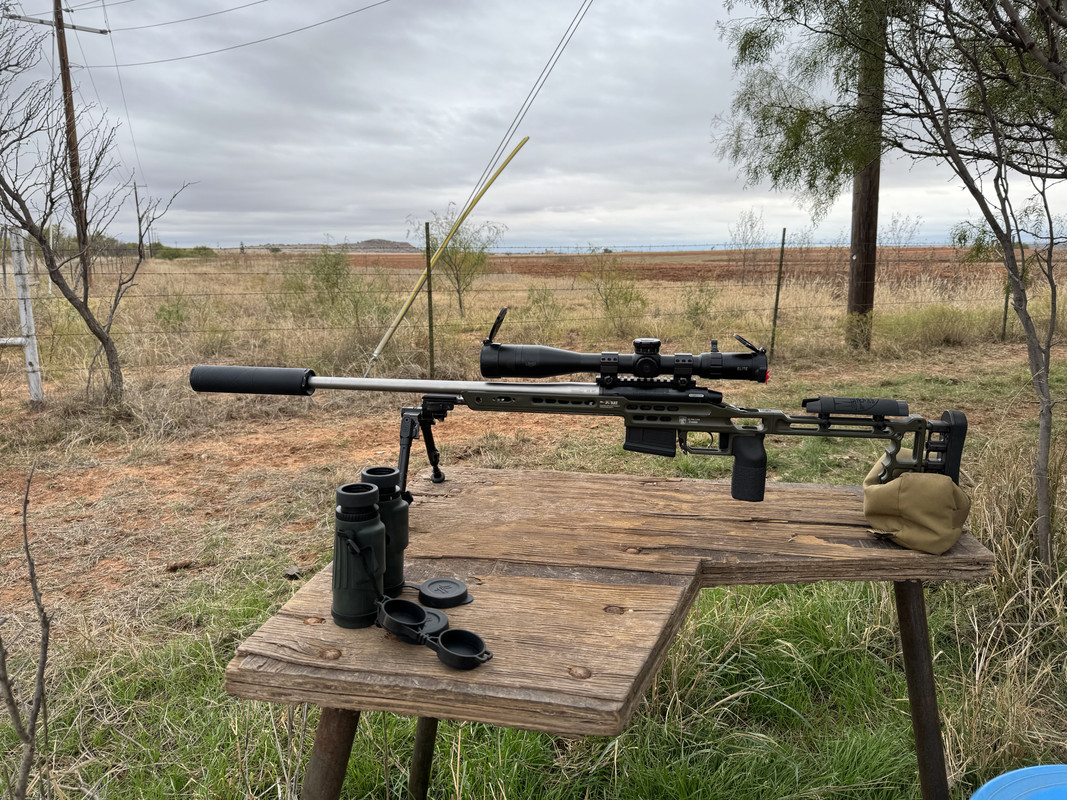

Had Jon Beanland spin up a .22GT barrel for my hunting rig. As per usual, the chamber is perfect.

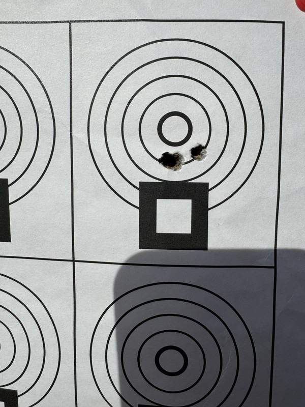

And, as expected, it shoots. These are rounds 30-35. Four of the five went into .127.” The “flyer” opened the group to .452.”

A little more load development produced this group out of my hunting rig.

That is pretty darn nice.
